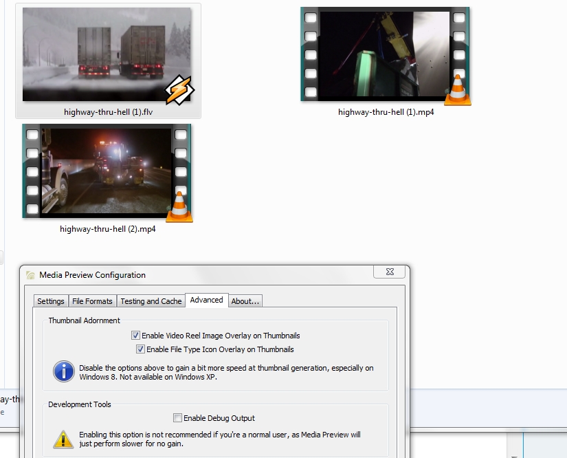

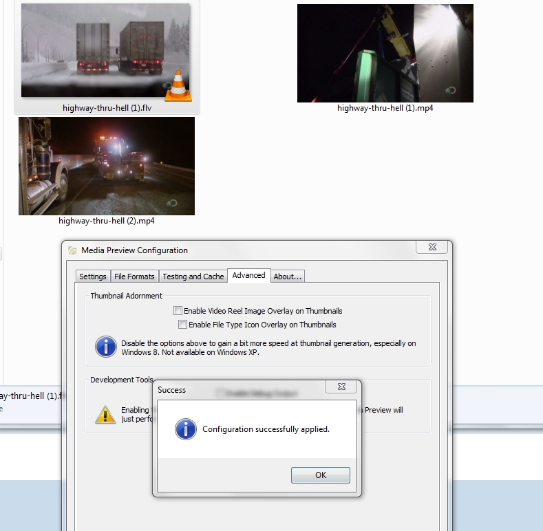

I can't remove file type overlay on flv files and the flv's won't take the film reel overlay.
All other files work fine.
I tried to change default player from vlc to winamp, it still displays either icon. I tried to clear cache, rebuild cache, check and apply settings, uncheck and apply, no change.
Is there a reason for this?
thanks.

- Phenom II X6 2012019.jpg (196.49 KiB) Viewed 61518 times
- Phenom II X6 2012018.jpg (185.31 KiB) Viewed 61518 times
- Phenom II X6 2012017.jpg (189.72 KiB) Viewed 61518 times

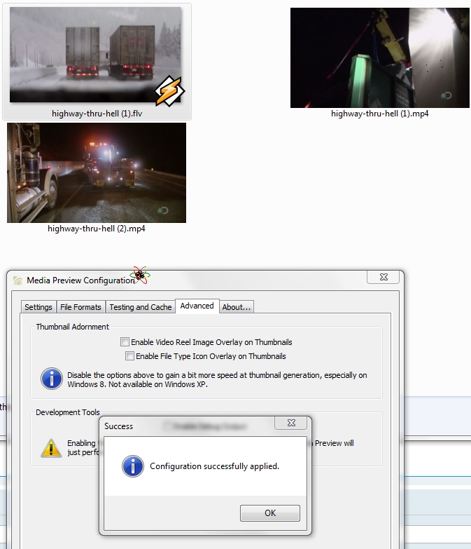

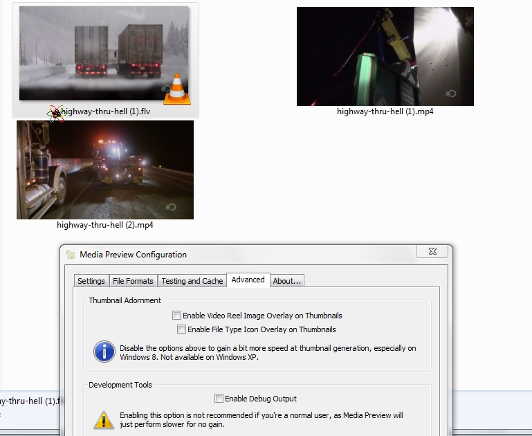

I am using win 7 x64.
I tried to use winamp as default player on flv's but it just shows the winamp overlay.
So no matter what player I use, the overlay is there to stay.
And as I mentioned, the reel image won't wont on flv's either.
Other than that it is working ok, thanks for your work.
- Attachments
- Phenom II X6 2012020.jpg (202.38 KiB) Viewed 61510 times

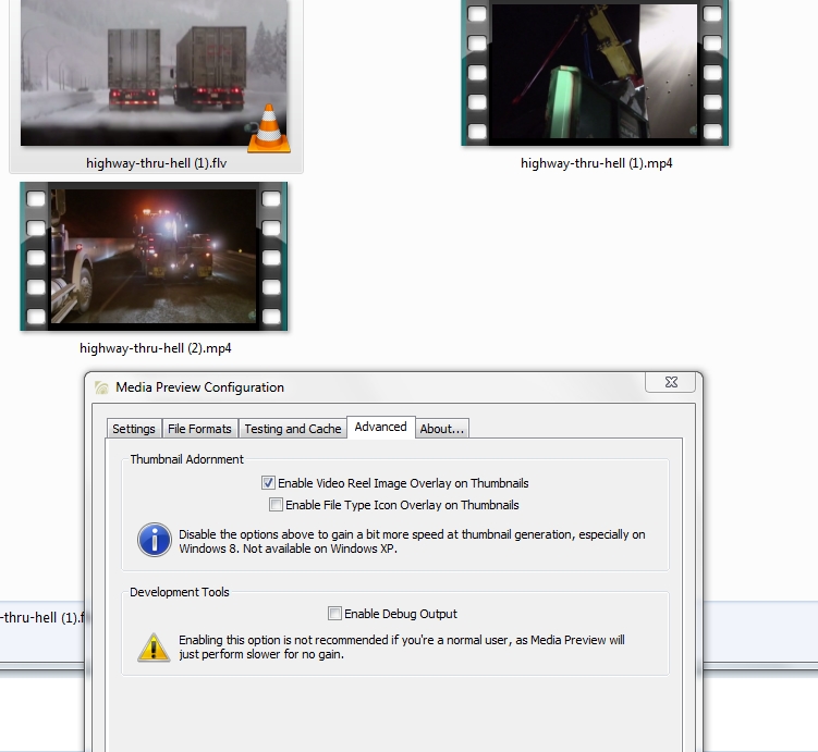

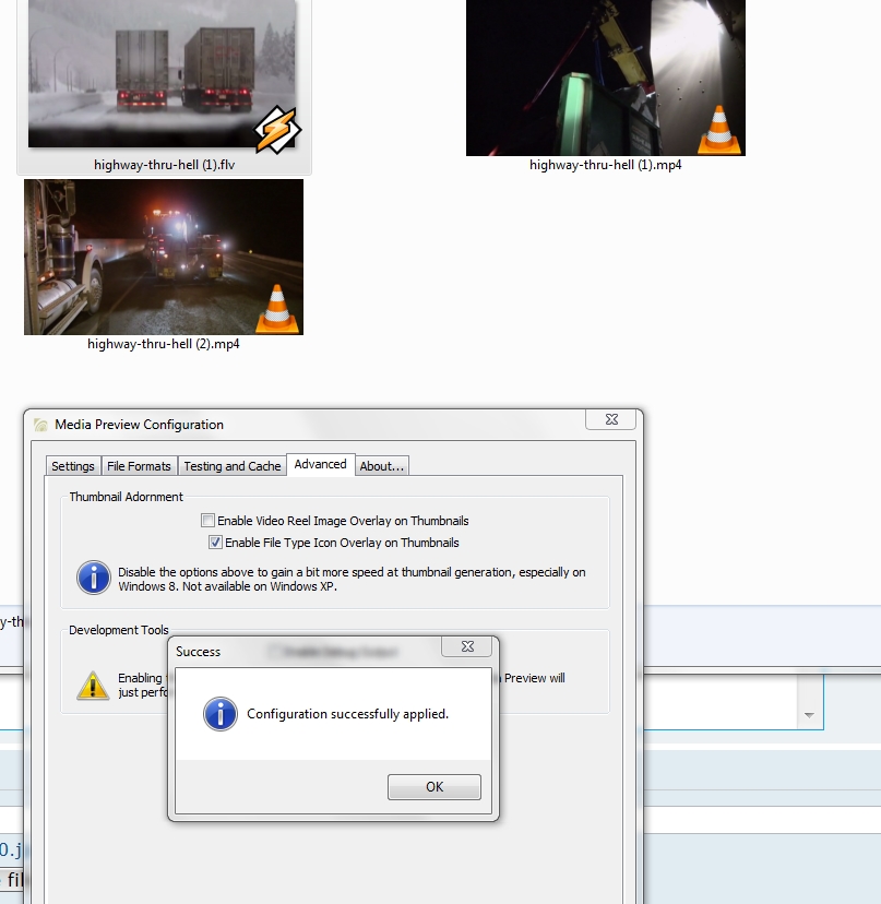

Here I tried with winamp as default.
It seems to not matter, overlay won't remove.
- Attachments
- Phenom II X6 2012023.jpg (207.03 KiB) Viewed 61494 times
- Phenom II X6 2012022.jpg (197.5 KiB) Viewed 61494 times
- Phenom II X6 2012021.jpg (197.17 KiB) Viewed 61494 times
